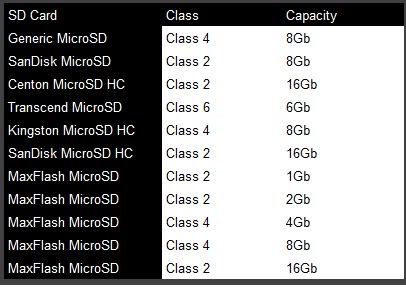

Post Re: Contour HD - Tips & FAQ
g`day Simon, we went through that with the GoPro (see that thread)& advised them too, they were recommending min class 4 but sending class 2, they've sent out info sheets & corrected it.
I'm purely going off what Contour said does work also, found it doesn't work that way, their looking into it.
This is their tested list, the Max doesn't work even in class 4 or 6 but sandisk works fine in class 2,

I think it would have to do with the fact that sandisk manufacture above the minimum spec. max is probably bearly making minimum spec.
so a class 4 sandisk is = to a class 6 where as a Max class 4 is class 4 just.
Sandisk are the world leader in SD cards
I think it is well worth spending a little more on the cards to ensure you get your footage!
lower class cards can also cause audio issues due to the pipe being maxed out.

i always thought the same with sandisk, but they report lots of corruption issues in video, the GoPro ones now recommend Kingston & that's pretty much all i use and have not had a problem with them at all, but yep - i think you're right with min/max variations & some just meeting it, what is crazy though even if it just meets 4, shouldn`t be an issue as they'll work on 2. Good that VholdR are researching what they claimed as suitable though, i've had some feedback already & it's good to see.

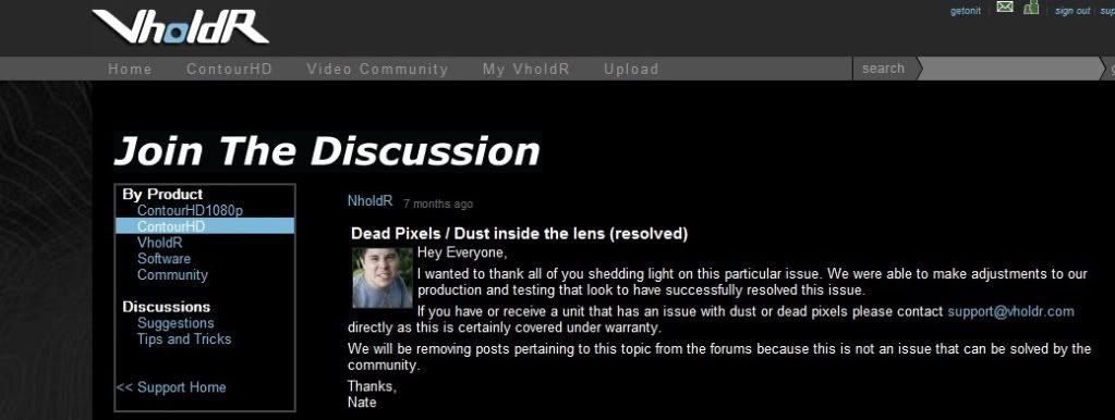

1st 5 minutes of our ride today, the camera lense was full of dust on the inside ! This is a warranty issue & Twenty20 have the problem sorted apparently, so for everyone that has recieved/pre ordered units I am waiting on a cross reference with the units against their serial numbers & I'll let you know if yours is affected.
They should be doing a recall rather than just waiting for users to complain

their own guys posted this on their own forum so I would expect it's covered.
This is the reply I got, I have since replied & will let you know of the outcome, "silicon around the lense protector" defeats the purpose of an adjustable point of view - interesting !
Thank you for contacting support regarding your problem about removing the dust behind your lens. Unfortunately, this is not considered to be a warranty issue. In extremely dusty situations this may occur. However, it should be relatively easy to clean this. If you first remove the single screw on the lens cover, you should be able to twist off the lens cover and clean the protector this way. While we do not have an official way to prevent this from happening in extremely dusty situations, a few of our customers have reported success by running a very small bead of silicon around the lens protector in order to seal it. I hope this information is helpful. Thank you for your understanding, and if you have any other questions, or if there is anything else we can do for you, please let us know and we will be happy to help you.
