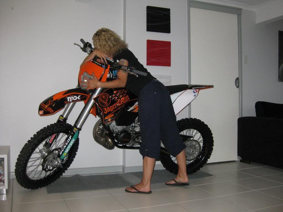

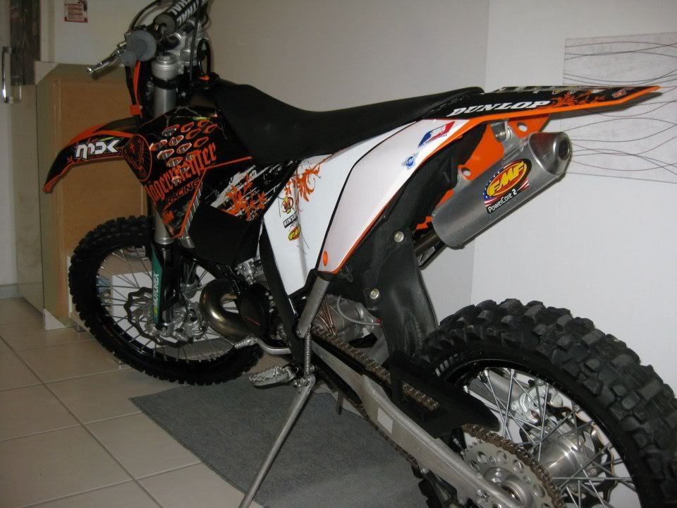

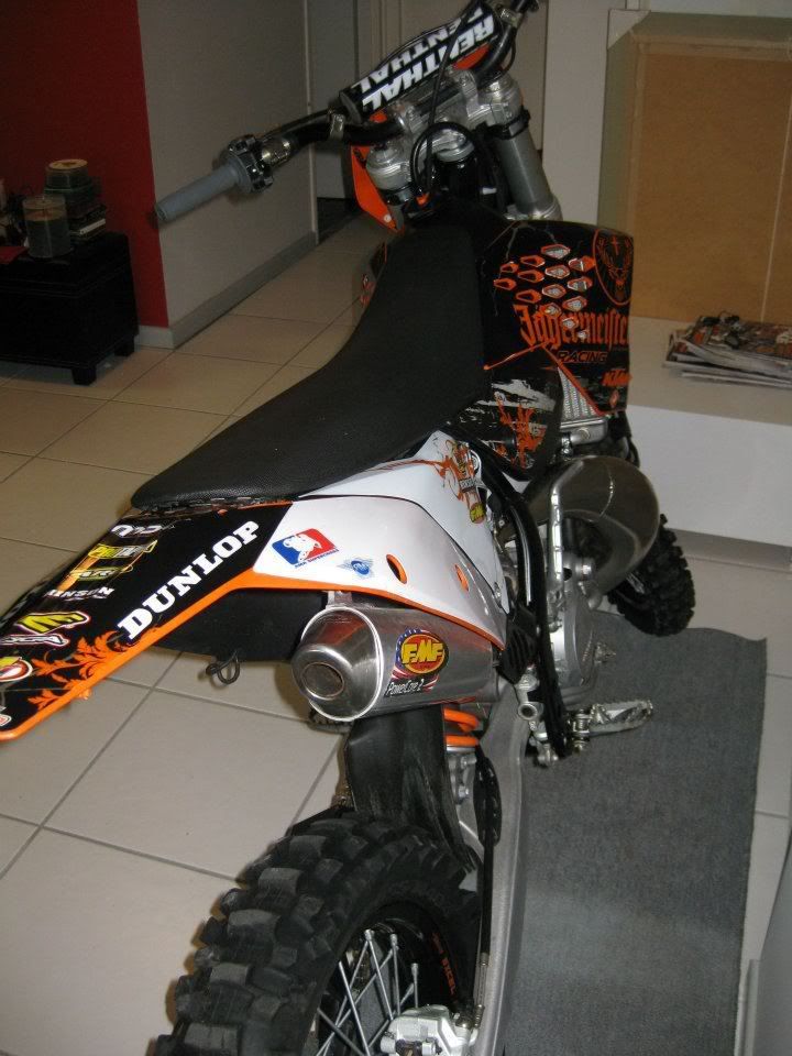

Post My 2010 KTM200
[photobucket]ImageImageImage[/photobucket]
Needs fat bars...any other suggestions of bits n pieces I should buy...bark busters...radiator guards.....and...

Definetly get an Exhaust guard for it. There are diferent soughts on the market. But i think the whips brand is the strongest, and most protective. See if freaky has any more of his hand guards left over. Take it out for a ride first, but see how your gearing is. Dont know what your running ATM, But you might want to change it to climb hills a bit better.
PS: As for your bars. Dont worry to much about them yet, Get out and ride it, then you can determine what bend and height you need. I think i may have a ktm bar hieght kit, thats if you want to raise your original bar height.

i would add a bash or skid plate to the list. looks like a tiidy bike

Very nice, another 2 banger to the fold icon_thumright . I just have a cheapie anodised protector on my expansion chamber and appears to the the trick. Enjoy

Thanks guys...will leave the bars for now n see how I feel when I ride it (if the rain ever stops )....will def get something for the expansion chamber, esp since my yz just copped a nice lil dint the other week...poor baby.
As far as gearing goes...treat me like an idiot when it comes to bikes as I know nothing, so cant help you there...but Im learning !
I emailed Freaky RE guards.
Now all I need to do is ride than dam thing !!!
Oh and do the suspension....

very nice!!! hello2 looks shiner then my TM atm haha a pipe guard is a must!!!

Noice hello2
I,ve run a few different pipe protectors over the years
and still trashed all of them
The carbon fibre ones are good ( but bloody expensive )
I,ve found the cheap alloy one ( like Squidly uses ) is nearly as good as the carbon 1 but a helluva lot cheaper ( see photo ) and yes you can get them in Orange
Don,t bother with the full Hyde pipe protector BangHead
Every now and then i take my pipe in to Full Throttle Motorcycles and they take all the dent,s out of it for me , cost me $ 60 last time and it looked like poo
B@B bash plate would be a good idea and some Force radiator guards
I reckon you gonna love that thing , there a great little bike icon_thumright

nice bike - welcome to the 2t club hello2
Barkbusters and radiator guards is about all you'll need, wire your grips and run over all nuts and bolts. I run my 250 at 45:1 on Castrol TTS seems to do the job. Also have a play around with the powervalve springs to see what your happy with and ENJOY.

Very nice Kylie... well done hello2 hello2 hello2 You can now worry less about have no rego etc...
As previously said, I would go rad guards, hand guards, bash plate and some sort of pipe guard. Thats is order of my preference.

Wrong gaurd Luni, yours is on the wrong side :o :D . Cheap bang for buck protectors Kylie!

No changeable springs on the 200
